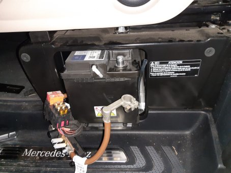

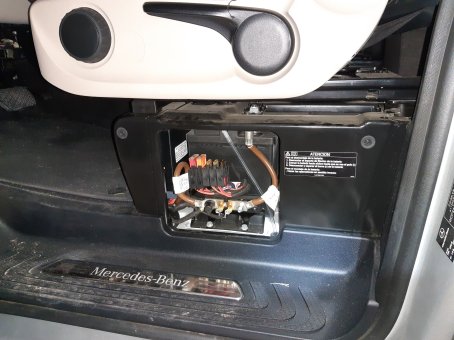

1 - pull firmly off the plastic cover to expose the battery:

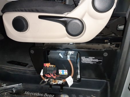

2 - remove the two screws that hold the battery firmly in place and also support the fuses and the shunt. Remove the plastic venting pipe:

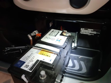

3 - Pull the battery outwards. It is heavy, apply some force. When the negative lead shows out, unscrew the terminal.
4 - Pull off the battery again until you can reach the positive lead, then carefully unscrew the terminal. Rubber gloves and extra care advised. The wrench will come close to the metallic seat base.

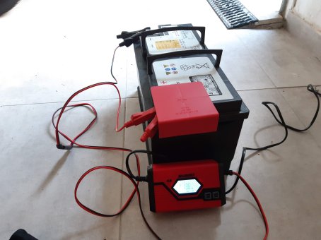

5. Fully remove the battery and let it charge for some hours while you appoint a visit to spine care and make a resolution to go to the gym more often.
That is, as far as I know, the proper way to remove the battery(ies). In case of doubt, it is quite clearly stated in the sticker next to the battery (in the above pics, in spanish-from-a-german-translator, just like all the other stickers in the van).
