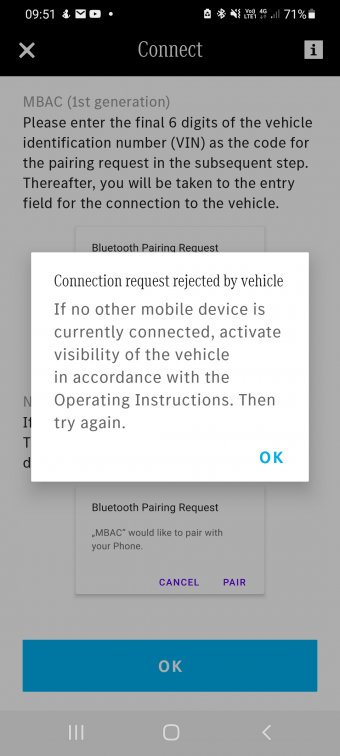

Hi all, my mbac phone app stopped working last month. Reinstalled the app and now it "the vehicle won't accept". In the mbac settings in the mbux. If I try and press the "make visible for all devices" button the little blue box won't illuminate.....
I've asked MB support and quite Frankly they are useless. Any ideas???
BTW I've never had the roof option. However I noticed the app I Reinstalled looks slight different to the previous one.
Give it a day and try again?! It's definitely a bit finicky and if the Bluetooth isn't rock solid it can play up. I only use it in and immediately around the van and it's reliable at that range.
I've gave it about 6 weeks mb support recommend a trip to the dealer. Not massively important but very frustrating
Hi
I've recently stubbled on the same thing after smashing my phone... Ill let you know if I can force it to cooperate. I think its because the bluetooth is still paired to the old phone and doesn't seem to delete it properly to pair to the new phone.
Hi
Update for those interested:
I eventually succeeded. I had to delete all devices from the MBAC and I deleted the App, redownloaded and installed and with a few attempts it let me pair via the last 6 and 8 digits of the VIN. I did note in the app you end up having to click through the instruction screens to activate the pairing so this might be stumbling people as its not obvious and the blue light on MBAC went off during the pairing process but I ignored this and it didn't seem to effect the outcome.
