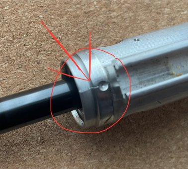

Hello… cause found! Left hydraulic cylinder broke. Now I need help to find another one because I guess is not easy repairable. Does anyone know what is the part number? There’s no information on the part.
