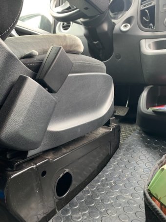

So I'm assuming that the air inlet was just been mounted into the existing plastic panel that covers the side of the seat box in the space between to the two front seats?

inlet is just simple hole in seat box, picture attached

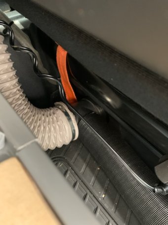

outlet splitter: using Eberspacher ”T” pipe, picture attached, hard to get better detail as there is mounted kitchen box behind that seat, black alu pipe flows into cabin, grey hose flows up
