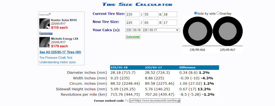

**still bigger than mu current set up on this calculator ?I
You understand my worry as my current 18''ones you have seen picture of?
