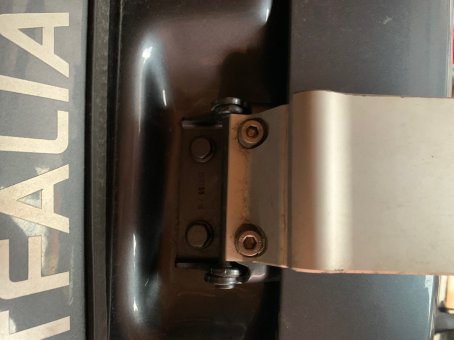

does anyone has that solar panel and use bike rack mounted at tailgate ? There is rack alu holder mounted directly to hinge of the tailgate, so not sure if this would effect cable running around the hinge
I've installed my kits on plenty of MPs with bike racks like that and they made no difference.
