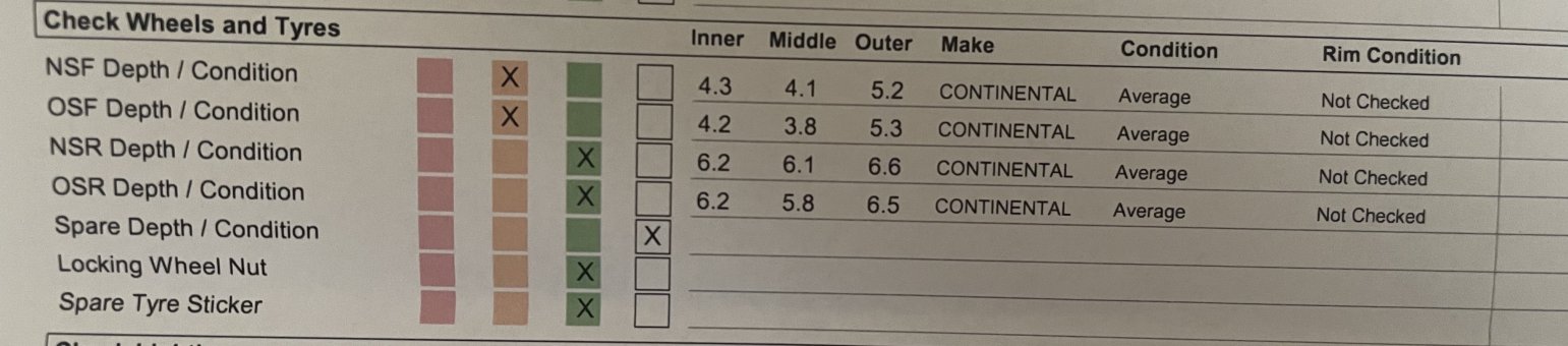

The results after 12 months of 45psi. The fronts were on the rear the rear tyres were new. At the time
The fronts have done about 11,000 miles and the rears about 3000 - roughly.. we had a double pot hole blowout on the near side when the car was under 1000 miles - and i had a puncture on the rear last summer - had both rears replaced and put on the front and fronts moved to the back.. kept the good tyre for the next incident :)
