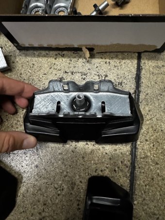

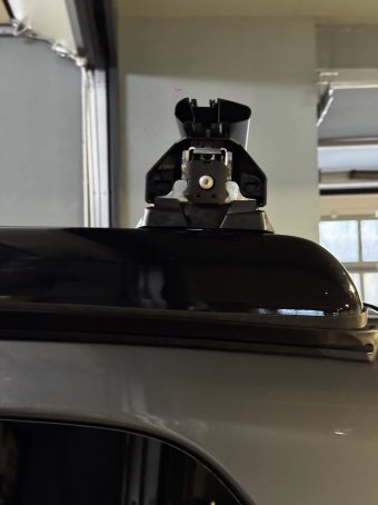

I'd like to reopen that thread as I bought MP W639 and I'm thinking of installing box on the roof.
I found all parts in the shop, just would like anybody to confirm that this mounting kit fits MP rails, could you check it and confirm?
https://www.e-bagazniki.pl/czesci-d.../kity-thule/seria-3/kity-thule-3084,6129.html
just wonder how this kit attaches to the rails, not having T-shape fixing bolts...
or maybe I have to attach mounting kit to any of the holes in the rails?
please advise or maybe send some closeup photos of already mounted kit..
thanks in advance for your time

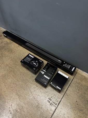

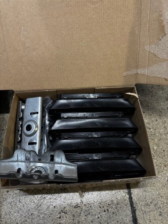

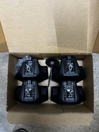

Hey,
I got this: https://www.nosice-stresni.cz/detai...benz-v-class-marco-polo-4-dr-autobusus-2014-/
It means:
TH753 - bottom. It fits the T-section in the roof.
TH3084 - mounting kit. It connects the rail and the bottom piece.
+ All Thule bars are compatible with the TH3084. The length should be 150 cm (roof rails have 130 cm + 10 cm on each side).
Remember that the maximum load (including roof rack and roof box) should be 60 kg maximum. As a result of overloading, car roofs often crack.
