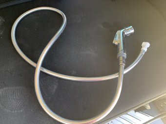

Overall cost was £8 (adaptor), £10 (hose), £10 (shower head). Time to do: about 10 mins. And you get the chance to personalise your shower system rather than pay for an over-priced MB version, so you can put the saving towards something else for the van...
See pics:

I did something similar to that and a bit cheaper, but I think yours is very impressive. I used a different RS fitting - there are 100’s of them - but your solution is much neater. Well done!
The RS part I used is actually the same as tobyw’s.
....I bought this hose with a 6mm diameter which fitted perfectly post cutting off one end (push hard to get on, but no heat required and impossible now to pull off)...
I bought something similar from Amazon. Tip: Once you have cut the end off, soak in a cup of boiling water for a couple of minutes. Slides on easily then once cooled, as you say, nigh on impossible to pull off

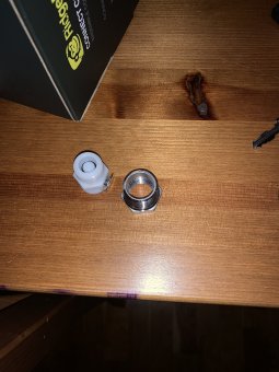

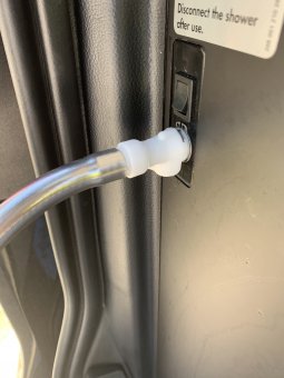

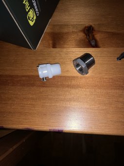

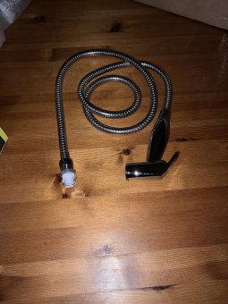

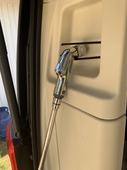

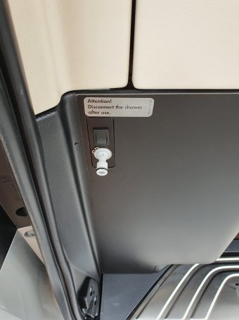

Another variation on the theme, again from RS, but worked out cheaper and easier to do. No cutting of hose required, yet to test it with any water.

I *think* I've sussed what connector it is. I've ordered one from RS today so will let you all know tomorrow if it fits. Would then need a bit of hose and a shower head but those are cheap cheap. :)
Thanks Brian - managed to get one and the shower worked really well until I snapped the connection on the vehicle side any ideas where to get that replacement by any chance ?

Big kudos for this from a new owner.
Bought the same shower head & attachment but unfortunately couldn't get hold of the b&q hose. Got a screwfix version (critically still 6mm internal diameter) for a bit more money but all works like a treat. Still much cheaper than the MB version and all the fun of doing it myself!

I got my hose on amazon, looks even better than then mb one, I've also upgrade the shower head, it cost me 45 in the end, but I'm very pleased with the quality, haha.
