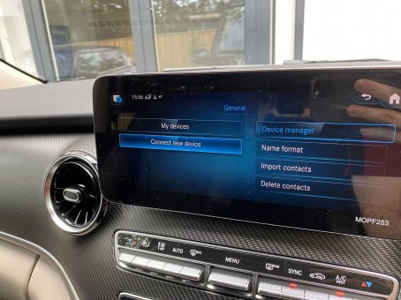

mbux is connected via the telephone Bluetooth screen. Like any other car you’ve connected to Bluetooth. Easy.

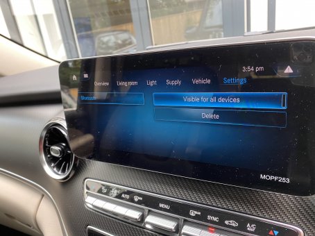

mbac is connected via the advanced control option. You follow the screens in the app and u have to make sure that the ‘visible for all devices‘ box is activated. It will then connect and u enter the last 6 digits of the vin number. Then on the next screen u enter the last 8 digits of the vin number (me neither?) and it all connects. Because I had to enter the end of my vin I assume this means I have version 1. I don’t have the option to raise the roof.

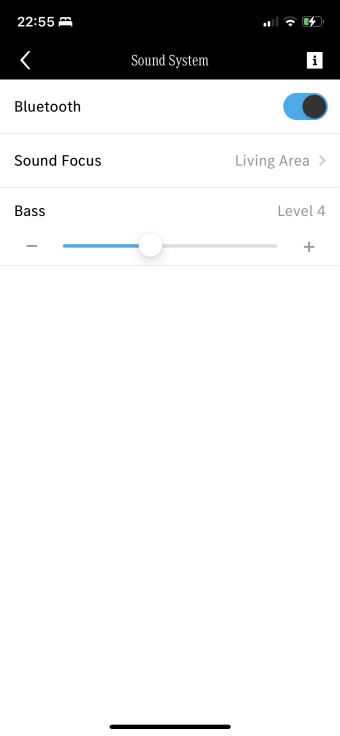

Does anyone else’s screen look like this on the section where you are supposed to operate the sound system? I can only change the base and whether I want sound focus in the front or back. So not much use. I mean volume and a play button might be useful!
