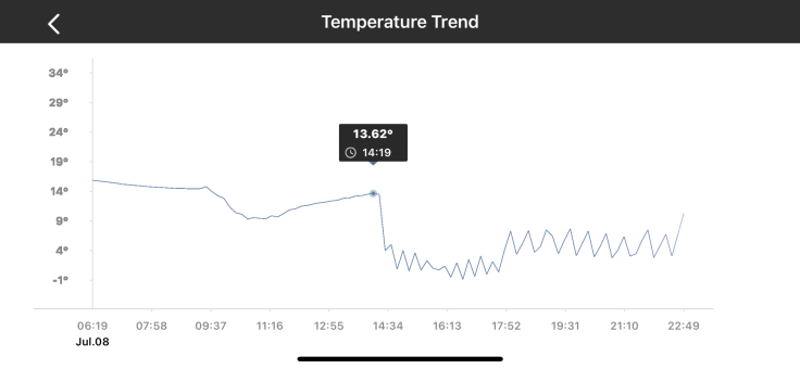

As per title, have searched through the forums and sure I saw a post about this but cant seem to find it.
When on setting 1 the temperature is all but freezing, this hasnt always been the case and was wondering if anyone has had similar issue and been able to reset it somehow?
