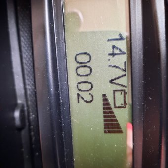

This is my battery reading today on the Westfalia console monitor MP battery reading.jpg Is this my main battery under the driver seat, or the leisure battery under the passenger seat?
I think Tina that this is the leisure battery voltage. All looks well. I have no idea why the battery symbol is “crossed” out.

Good morning. Yes, I have hooked up to the mains, 240V, via the cable on the left hand side of the van, where the water inlet is also situated. That is why the Error of the battery, slashed, confuses me.
I will do as you say, but I am sure I have done this, as I have tried every possible scenario to raise my roof. I have also just seen the amazing tutorial of removing the auxiliary battery, posted on here by another member. At least I know I am doing right in trying to take out the leisure battery. :-D

Hi Tina someone on the FB forum responded to say the leisure battery is below 10v I did explain that even with the ac cable connected to the mains you weren’t getting any movement.

Out of interest with the engine not running what voltage is showing on the display?

Would be interesting to know what the voltage reading is without the 240v supply connected or the engine running. Looks like it might be a duff leisure battery.

I wonder if being on charge is one thing, but the 12v sink/supply for use is not available (bad cell?) This would be critical for function, if the battery is bad <10v the status shows as charging, but there isn’t enough stored/available voltage to make anything work (possibly related to the “intelligent” battery monitoring that stops you from draining the system)
A test of the state of the leisure battery would be a good starting point for the diagnostic's list.

Yes great point. Again I asked Tina to tell us what the resting voltage is on the display. I.e. without the engine running or ignition key in the car. By comparison mine sits about 12.7v currently.
