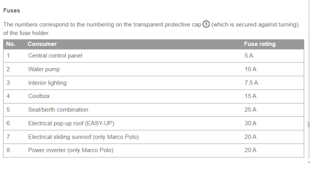

Agree with Mark, if there are no beeping sounds and its dead, try the fuse. Its below the fridge, 30A fuse

Awwww, thank you Mark. I am truly trying to stay away from Merc dealerships and trying to sort out the fault myself. Today, I popped home in my 2 hr break and purchased some new 30A fuses. I can see all the fuses under the fridge. I was so positive and excited changing the 30A fuse. Fingers crossed my electric roof/bed space will raise. IT DIDN'T! (I could cry!). I checked the fuses with my Multimeter, and yes, they show a reading so the fuse was ok. So it wasn't the fuse. :-(

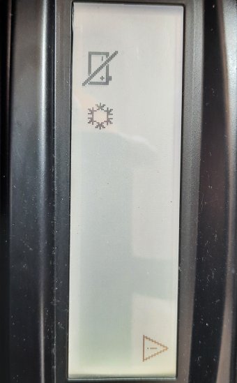

Thank you for the wise words of advice "Tread carefully". I did :) .... Ok ... I pressed both buttons on the Westfalia panel and two errors appeared: A picture of a battery with a slash/line across it, and a picture of the Cool box icon. So, I tested the 15A Cool box fuse and there was a reading. I also turned the Cool box ON, and it got cold - So, all is working there. Brill! So, that leaves the battery error. This puzzles me as I have had my Marco Polo hooked up onto my main electricity for two days now. The Westfalia panel shows the leisure battery is full (this is the leisure battery reading, isn't it?). All vertical power lines are black and it shows 14.7V. There must be power in my leisure battery for the coolbox to get cold ... Yes? The water pump also works (water comes out of the tap and the shower in the rear). So why is there an Error picture of the battery? I also have a 'trickle charger' charging the main battery, under the driver seat. I do this when I leave my vehicle stationary for a while, as for some reason the main battery loses power standing still (probably the norm?). I can start the engine ok, so this means the main battery is ok.

Here are the Errors shown on the Westfalia console panel 20240628_141909[1].jpg
