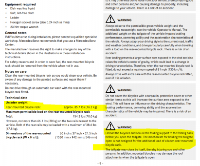

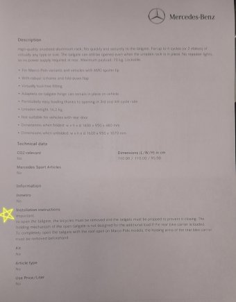

I'm looking at the MB tailgate bike rack instructions now and the exact wording is "the mechanism for holding the tailgate open is not designed for the additional load of a laden rear-mounted bicycle rack." it doesn't say that its not designed for the load of an empty bike rack. My instructions are from 2015 so perhaps its been updated since then
The line before that states "the bikes must be removed and the tailgate must be propped to prevent closing"

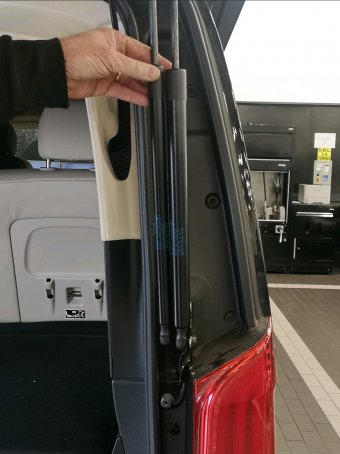

@Tee Ok we have been told its fixed. They have ended up using police strutts. The part number is MA4479800364/64.
And they look like this attached

However the strutts are certainly at fault and appears to now work correctly with the new part number. Only took Mercedes 6 months to address, and because its not a listed part for the Marco Polo they only came across it by chance. None the less resolved with the strutts

I’m a little cautious though. The struts you have are 1060nm normal struts which I believe are normally for non electric tailgates. The originals are quite complex Stabilus Hydro-Lifts with an external spring and a lock to hold open since they are only 540nm. This benefits in high /low temps and I think the strains on motors (that last point is a guess).
See here for the the differences: https://www.autodoc.co.uk/car-parts...ass/v-class-w447/141189-eqv-300-447813-447815
also the video on the 1060nm struts you have had them fitted the other way to yours on a Vito. Which I’d tend to agree with the junction/seal being at the bottom when closed
