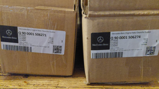

All good now. I had Mercedes Los Barios fit both new rams for 280Euros. I get the guarantee for labour and parts so I’m a bit happier although a touch poorer! I kept the old rams and will see if I can’t replace the seals and maybe someone else in this group might want them.
Roof working like a dream, and much quieter than previously. Hope it stays that way.

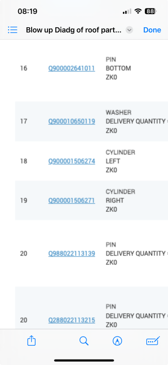

my MP is 2006 and your cylinders look different than mine.
yours are little bigger can they fit in mine MP too?
mine are : Q90000150271 and Q900001506274
Hi,
1708676478068.png18 and 19 are the ones for my 2004 camper. I will try and get you the telephone number for the helpful Mercedes dealer in Austria. He managed to locate the rams for me.
Hello, I have exactly the same problem as described above. Can you please send me the contact details of a Mercedes dealer in Austria or anyone who might have the cylinders? I need at least cylinder Q900001506271 (the one on the right) Thank you in advance. Greg
