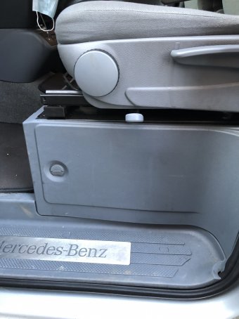

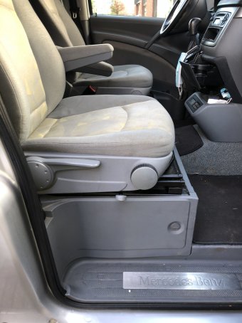

Don't know if this helps, but my MP has the Auxiliary Heating option. This sits under the passenger seat (nearside of MP), the leisure battery is under the driver's seat, and the main battery is in the engine compartment. Seems there are various positions for the various batteries !!

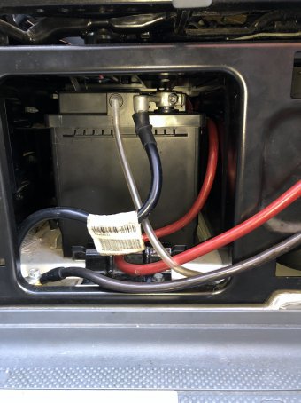

The thing under the hood looks like a battery, it even has a + power hookup for jump leads but it’s not a battery, it is in fact a relay box. Pop the cover off and take a look.

The leisure batteries (we have two on under each seat) also stopped holding their charge when the motor is off in a few minutes. So we’re going to have to replace them.
I discovered that there were two when I was preparing the wiring for the inverter and solar controller.

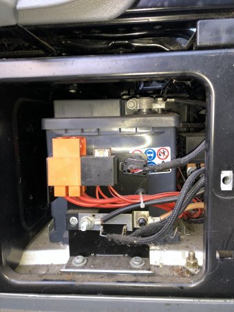

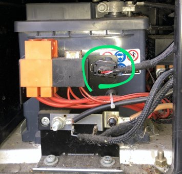

Hello. Can anyone tell me what this thingy is?
Regards.
No , there are 2 batteries. One is a normal PB Batterie for starting etc under one seat. Under the other seat is a batterie with no fuel inside but a gel , this is the "camper "batterie. Difference one is for havy starts ( the normal car battery ) and the other gel batterie is a batterie which can deliver low current over a long period of time. Due to the fact that there are 2 different battery load models , they are not interchangeable and even DO NOT PUT a normal car batterry inside of the Gel batterry compartement , The batterry THE BATTERYY WILL BE BLOWN UP !!!!!!! so CAREFULLY !!!!!!!!!!!!!!!!!!!!!!!!!!!!!!!!!!!!!
This Viano has 3 batteries! The main in the engine compartment, a helper (also gel) under the driver’s seat and a second Gel leisure battery under the passenger seat which was swollen and replaced with a new gel battery.
