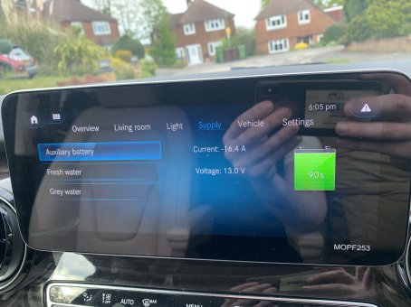

I have had my new MBUX V200 Sport since January and havent used it much.
I am getting a frequent error when the van is parked up that the leisure battery drains and when I retsart I get a white leisure battery warning but also an yellow driver assistance non-function warning (radar cruise control).
I noticed today that when driving the leisure battery had a wildly fluctuating charge current (from -10A to +32A) with voltage fluctuating from 12.7V to 14.9V over the same period. The leisure functions were all turned of and the engine running.
I am assuming the cause is a duff leisure battery but could it be something else? It had a 40 minute drive and the charge state of the battery moved initial to 60% and its now there regardless of what I do (previously I have found it tops back up very quickly once the van is driving)
Any advice?
