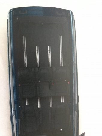

MB has the same single seats for V-class, Vito Tourer and MP Horizon/Activity where rails pitch is 35cm, just keep on mind there have to be also brackets in the rails where the seats are mounted
As far as I am aware you need to understand that some seats won’t fit the Marco Polo because of the kitchenette and the (2) rail configuration, however I think the Horizon or at least the 2018 horizon has 4 rails so most maybe even all of the Vito seating options will fit. As @caMPike says the rails also need the sliding blocks to accommodate extra seating. We looked at getting the table for our Horizon from the earlier V-class but this table only fits to the dedicated, extended rail type that has extra rail fitting for the folding table.
I am not sure about the Vito tourer fittings they do look the same so I have to presume that any single or double seat would fit the full fat MP and the folding/three seat option would also fit the horizon. This is my conclusion anyway but I’ve not yet had the option to test this.
It makes no sense for MB to change the rail system between model variants. But until this has been tested I really cannot be sure.
Ahh yes the rear of the vehicle Vito is set up for a parcel shelf, the outer rails are longer to accommodate this. The MP uses this to fit the bed extender. So the Horizon and the Vito has the capacity to take three seat all the way to the rear door but you may have to remove the fittings for any parcel shelf/bed extender as they somehow fit into the seat runner in sliding rail..
The Marco Polo (with kitchen) would (I guess) be the same and take a double seat to the rear door if needed. I think newer 2021 MPs have a different rail setup so you need to check what this is and which model best suits your needs.
