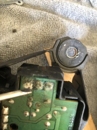

I openen one of the €250 wiper motor assembly and found corrosion on the pcb due to leaking washer fluid connection.
After cleaning the short ( see photo) and adding a protective layer grease as well as a couple of o rings at the water fitting I think it’s time to tear the back apart to replace it with my “self revised “ and improved motor assembly.
I was working ok until one day I decided to use the washer function. And as expected, 2 days later it started to turn on intermittently then permanently.
So F7 out and waiting for some reasonable weather to do the swap.
I’ll keep you posted and I have a series of before and after photos of the inside.
I also suspect the internal relay but well see.
