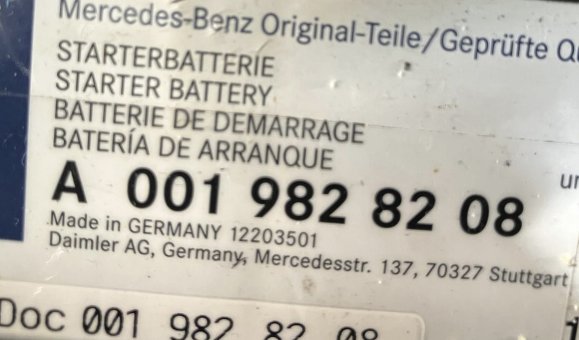

I hope that someone can help. I have a 2018 (W447) Marco Polo and the roof won’t open or close. It makes a vague attempt and then nothing happens on hook up or via the auxiliary battery. I have replaced the aux battery and the aux battery relay that solved a problem of the battery not charging or holding the charge. The roof failed open and I managed to override it using the emergency procedure. The Westphalia panel shows that the vehicle is on hookup and that the aux battery is charged. The roof shows that the roof is closed and on pressing will show open despite the roof not really moving, but does make a small noise that suggests that there is some action at the ram. Having searched the MP forum, I have checked the 30amp fuse on the panel below the fridge and it is good; I have checked and tested the microswitches, including overriding them and tested the roof on and off hookup – but no result. I have accessed the error codes and they read as follows: 01/011; 02/131; 03/130; 05/170; 05/120; 06/125; 07/110. My questions are as follows: a) What is the purpose of the microswitch, it appears that they provide feedback that the roof is closed b) Has anyone any experience of being able to check or change the electric rams on each of the arms c) How can you raise the roof manually? Looking forward to any help, wisdom or suggestions.
