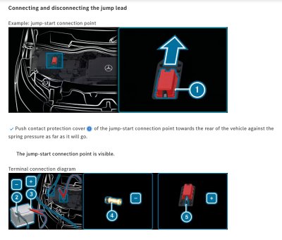

So an update a long last, all is well and the van is back up and running. The first problem with the locks, or should I say the only key ‘lock’ on the drivers side and using the skeleton key, I reverted to using a pair of big pliers to twist the key back and forth after lubricating and finally, just as I thought it might snap off - it worked open. Next I couldn’t open the passenger door manually, to open the main battery cover, luckily that opened once I placed a set of jump leads and life came back to the van. There wasn’t enough juice to start the engine, all the dash lit up and after waiting five minutes for some charge to cross over I turned the ignition key waited for the glow plug coils to go out and - nothing all went blank until the key was released again. So pulled the main battery out, recharged via CTEK MXS 7.0 charger, no difference, then pulled out the leisure battery. That measured 50% charge and topped it up to 90% and reinserted. Checked all fuses and starter relay, jump leads back on and waited 5 mins, tried the ignition and a one second response from the starter… tried three more times and engine fired up. Left it running 30 minutes whilst I rest doors, windows, mirrors and all other checks then after warming fully. Turned it off. Started again two hours later. Hopefully lesson learnt. Leaving it on trickle charger tails and watching battery levels more closer… as with stored motorbikes. Chargers now everywhere! Thank you one and all for help and advice… until we meet again!
theres charger pins in the engine room. D also your model looks like it has a CE powerplug. next time just use that and leave the relay on inside. D
the skeleton key is hard to twist.... its normal. but i can do it with my fingers.
GL
As said, no need to remove battery you can charge or jump with access to Battery cable system under front bonnet. EHU also charges main battery.
