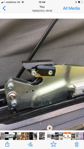

Any chance you can post a pic or part number of the offending split retaining clip? Suppose if merc sorted it out they’d have just thrown out the old part. Be worthwhile for others to check theirs or at least keep an eye on it.
It is a very sturdy component broken by misalignment of the roof in my opinion
Pics attached same item fits either LHS or RHS
