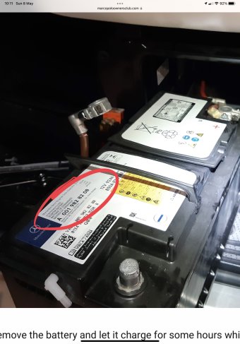

I noticed in an earlier thread showing pictures of the removal of the auxiliary battery that the battery is a Mercedes branded battery labelled starter. (see picture)
I was always under the impression that the leisure battery should be a battery spec for that purpose.
Has anyone tried swapping to a dedicated leisure battery?
Halfords seem to stock one that is exactly the same dimensions. See second picture
I have replaced my leisure battery (Located beneath UK passenger seat). It is identical to the starter motor one, (located beneath UK driver seat). I purchased from MB, price was not much different to Halfords. Takes about 30 mins to swap.

I did change it myself. When you pull the cover off the side of the passenger seat, all the fuses will be in front of you.
