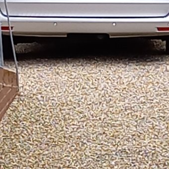

Good afternoon all, I have just looked at the rear of my M.Polo and the right side of the vehicle is 1"1/2 leaning from near side to off side. Nothing is inside, and all tyres are pumped up to 40psi all round.ANY IDEA'S. Dave.

i have a concrete parking area that looks flat and both my old and new Vito's did/do that... its probably not the van - try measuring it in a different location - tarmac carpark or some place that is mechanically levelled - filling station forecourt? - gravel (if thats what it is) is very fluid.

I have remeasured the difference in hight on a block paved level driveway and there is 5mm difference in hight. ie suspension springs i guess. Regards Dave

Back to the spring. Have you noticed and strange rattles at the rear on the low side? If a spring breaks near the end the short end sometimes rattles in the cup.

I think the van ride height is fine - dodgy test data I think.
