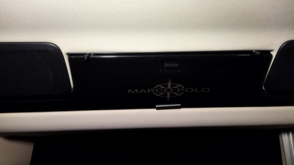

I have been having a little trouble with the rear locker door slamming open when hitting even a minor bump in the road (the locker with the MP logo on it).

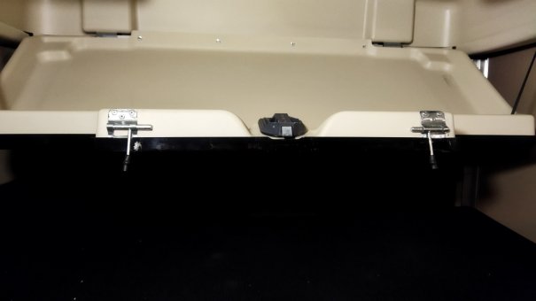

On inspection it seems the gap between the door catch and the locker surround is simply too large and the latch is not engaged enough to keep the door shut.
I spoke to my local MB dealer who told me that there is an official MB "TIP" document about this repair and there are some official MB plastic spacers which effectively space forward the hinge to make the catch engage at the front better. But he couldn't order them as the part did not exist on the system for MB UK and he would need to put a request in from Germany...blah, blah and on and on.

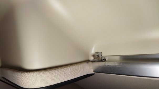

So it's easier if you just fit some washers or a spacer to gap it correctly yourself...remove the rear roller blind by popping off the plastic end covers and removing the two screws, if you're lucky and you have the right tools you may be able to loosen the hinge bolts from here but the access is poor, so if not remove the door seal a little and the plastic panel that is in the way and voila you are on easy street!
The official gap for the door to cupboard shell is 3mm but I would make it a little tighter if you can, just check the door opens and closes without interference.
