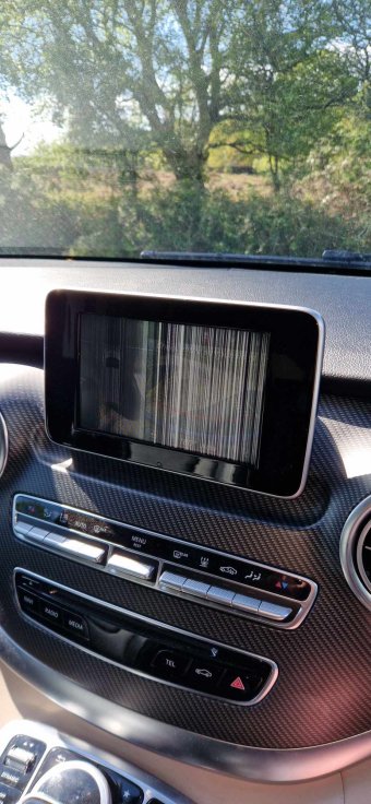

Hi everyone my screen did this today !
What’s the best option try to avoid main dealer - probably say sometime next year and huge £
I can get screens on line.. any ideas asap !!?
Thanks in afsvance
(It’s an intermittent bar code showing)

I don't think it's a screen issue. From the picture, it looks like there's interference which could be a cabling/interconnect problem or a software issue. It's worth re-booting the system (press the system on/off button on central console for 15 secs) and see if that makes a difference. I don't think it's uncommon on other Mercedes with COMAND (according to a quick search on MBClub and MBEC forums) so as Steve says, it's worth asking a Mercedes Specialist to diagnose - it may simply be a re-load or update of software.

Hi guys thanks - currently got a slot at Mercedes Portsmouth and will revet with findings. oput the phone down on Mercedes Southampton for beeing an absalute jole - 3 weeks?? ( And im their customer and its a warranty item!!)

Update: just been told new Command center £1500.00 - joke being that its not going to get any Navigation/maps/upgrades as the SD card has been discontinued on this vehicle 2018 - and impossible to get anothe ( MBUK) - where does that leave me now plus others??

Hi - touch wood all sorted reboot with software etc etc at present working well they even supplied me SD card (old one corrupted) £100!
The visit to Lightwater was £500- they said if it’s sorted great if not new command
But 99% sure- they would do a new command cheaper than MBUK and while I wait … with new SD card if required . All in all - what a service - refreshing to find a firm that « can do »! leaving for France next week !!
